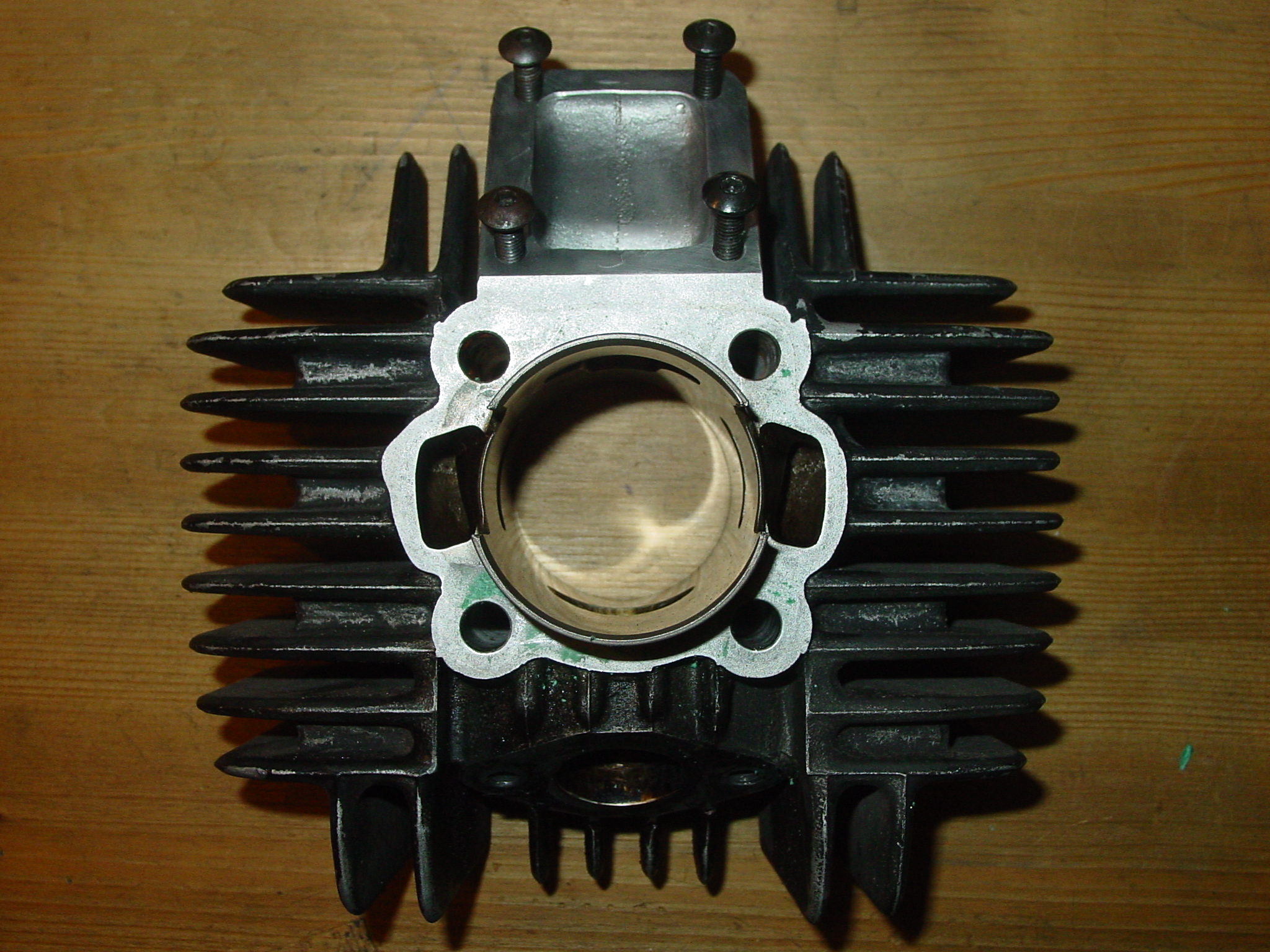

Is there any difference in performance if you remove the wall of the booster?
like on this picture:

booster?
It looks like a normal(fast) cilinder to me, please explain it a bit ;)

ooh at the inlet of the cilinder, It makes some difference indeed, but its not really wise to do so.
There is a too big hole in the cilinder wall in wich your piston ring can get stuck behind which will screw up your cilinder.
I drove a while without that piece, and its not a very good solution to go harder.
Instead you could use a bigger carb or better exhaust.

It's not the best way to create more speed...

thanks for the advice and expalnation.
Berichtdoor Timo » 22 okt 2009 21:44
And it's not very effective at all.
